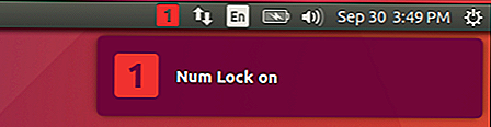

Since I upgraded to Ubuntu 20.04 I lost Num Lock during boot. Is there any way to keep Num Lock active during boot as it was before?

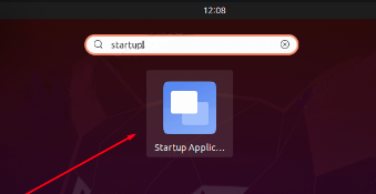

Method 6: Using the Startup Applications
The sixth method to activate Num Lock by default on Ubuntu 20.04 boot is by using the Startup Applications. Here are the steps:
1. Click on the Activities button located in the top left corner of the screen.
2. Type “Startup Applications” in the search bar and click on the icon.
3. Click on the Add button located in the bottom left corner of the window.

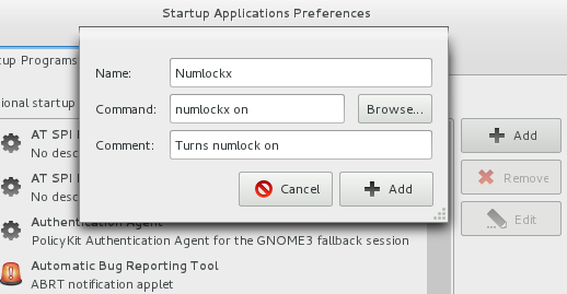

4. Type “Num Lock” in the Name field.
5. Type “/usr/bin/numlockx on” in the Command field.
6. Click on the Add button.
7. Reboot your system.
By following these steps, Num Lock will be activated by default during boot. This method should work for most users.

Try to install numlockx via terminal.
sudo apt install numlockx
Search for Startup Applications:
Set a Startup Application Preference with a command “numlockx on”.
Enjoy!
