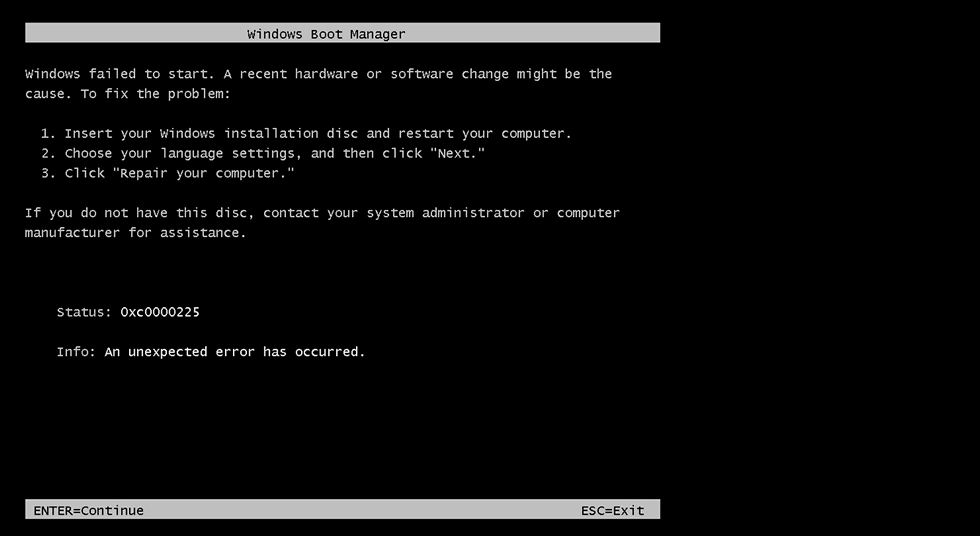

However, while starting up the computer using the USB disk, an error occurred during the “Windows is loading Files” process.
You can find a comprehensive description of the error message HERE, where it is explained that the 0xc0000225 error typically results from a faulty BCD. I tried to fix this issue using EasyBCD, but it did not make any difference. Despite the error, I can still access my other operating systems.

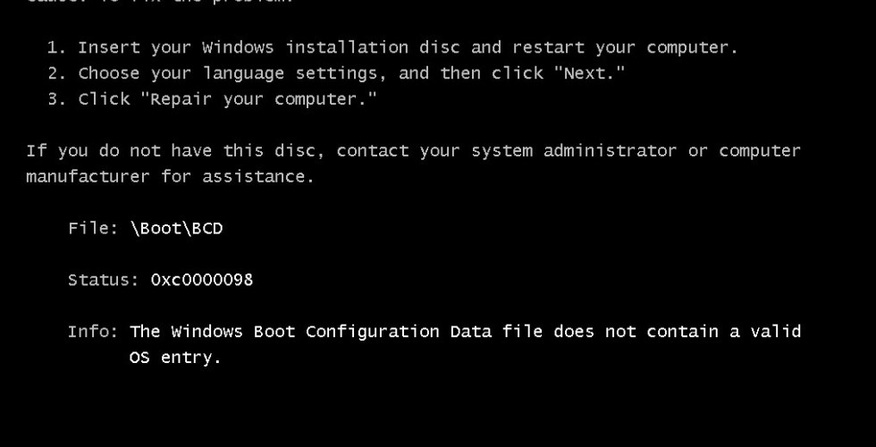

Although I can bypass this error message, I am met with a new one on the subsequent screen that appears:
You can find a thorough explanation of the error message 0xc0000098 HERE. This error also seems to indicate a missing or damaged BCD, but I am uncertain about this because I am still able to boot into my operating system.

3. Repair the BCD Manually
If the issue is with the BCD, it may be possible to repair it manually using the Command Prompt. This involves booting into the Command Prompt using the Windows installation disk or a bootable USB drive and running a series of commands to rebuild the BCD. A detailed guide on how to do this can be found HERE.

The error messages that you are seeing, 0x0000006B and 0xc0000225, indicate that there is a problem with the boot configuration data (BCD) on your Windows 7 system. This can be caused by a number of factors, including a corrupted system file, a problem with the boot sector, or a missing or damaged BCD file.
To try to resolve this issue, you can use the Windows 7 installation media or repair disk to boot into the Windows Recovery Environment (RE) and perform a startup repair. This will attempt to fix any problems with the BCD and other system files that are causing the BSOD.
To do this, you will need to boot from the Windows 7 installation media or repair disk. When you see the “Install Windows” screen, press Shift + F10 to open a command prompt. From the command prompt, type the following commands:
bootrec /fixmbr
bootrec /fixboot
bootrec /scanos
bootrec /rebuildbcd
These commands will repair the MBR, fix the boot sector, scan for installed operating systems, and rebuild the BCD. After running these commands, you should be able to boot into Windows 7.
