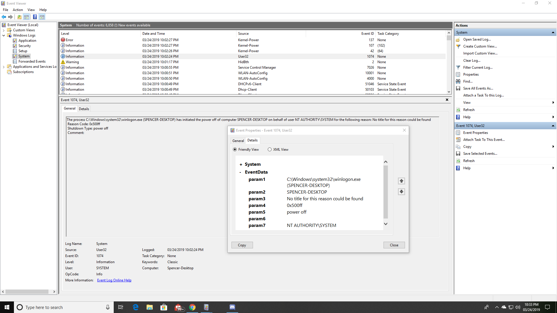

My friend’s computer has been experiencing unexpected shutdowns that occur without warning. These shutdowns tend to happen during gaming sessions, although there have been instances where it has happened while he’s watching videos on YouTube. According to the Event Viewer, there is evidence of these random shutdowns.
The process C:\Windows\system32\winlogon.exe (SPENCER-DESKTOP) has initiated the power off of computer SPENCER-DESKTOP on behalf of user NT_AUTHORITY\SYSTEM for the following reason: No title for this reason could be found
Reason Code: 0x500ff
Shutdown Type: power off
Comment:param1 C:\Windows\system32\winlogon.exe (SPENCER-DESKTOP)
param2 SPENCER-DESKTOP
param3 No title for this reason could be found
param4 0x500ff
param5 power off
param6
param7 NT_AUTHORITY\SYSTEM
I believe that this specific incident was the cause of the problem. The computer in question is a pre-built gaming PC made by Cyberpower. I am open to any recommendations that may help resolve the issue.

According to the knowledge base article, the Event Viewer entry mentioned may not be the actual cause of the issue. Instead, the real reason should be logged alongside it within seconds, with the same Event ID of 1074.
If you can locate the second entry, it may provide more insight into the issue. In the author’s case, the second entry stated that they initiated the shutdown using the desktop or start menu. However, in your friend’s case, the issue could be caused by a power button short, a malfunctioning program, or even CPU overheating in extreme cases.
For instance, the author’s custom-built system would restart on its own when overclocked too much.
Good luck with resolving the issue!
