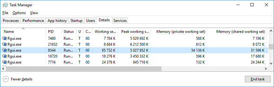

I am attempting to determine the overall amount of virtual memory that a process utilizes, which includes any swapped, cached, or pagefile data that may be stored on the disk. The statistics available in the Task Manager only pertain to the space occupied in the physical RAM, and do not provide information on these other forms of memory usage:

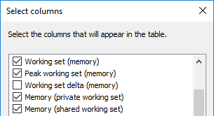

These are the memory-related columns that I have selected:
I have not observed any other columns that appear to correspond to my desired metric. Based on the output from R’s gc()
and memory.size()
functions, the expected value for this metric is approximately 2GB.

However, the “max used” value indicated by gc() appears to align closely with the “Peak working set” metric. It is unclear whether the latter pertains to the total virtual memory or just the physical memory usage.

to open the Task Manager. - Go to the
Details
tab. - Right-click on the top of the column headings and select
Select Columns
. - In the
Select Columns
window, check the box next toVirtual Memory Size
. - Click
OK
This will add a column called Virtual Memory Size
to the Details
tab, which will show the total virtual memory usage of each process. The value shown in this column is the total amount of virtual memory that the process has reserved, including any memory that has been paged out to the system paging file on disk.
