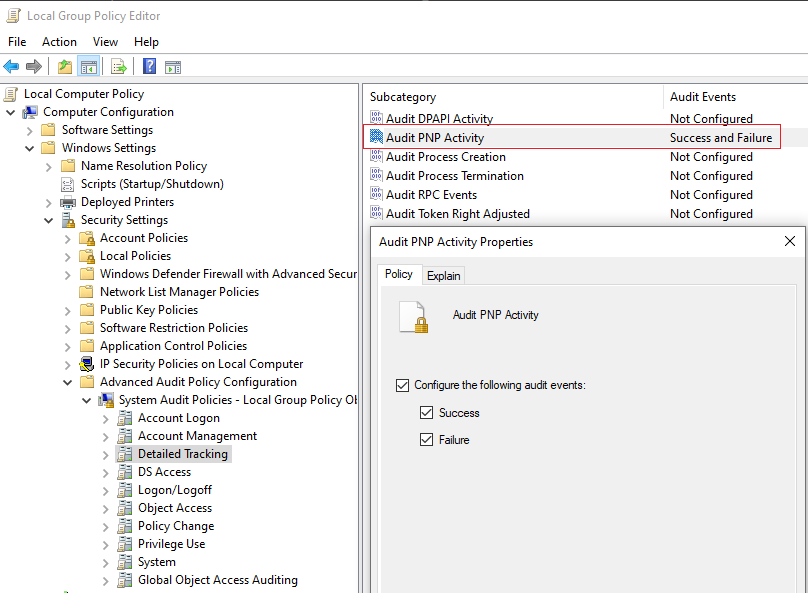

I have used usblogview which did show an offending peripheral, but even with that peripheral unplugged the issue is still occurring and usblogview is not showing anything. It’s possible the problem is with the USB chip on the motherboard. I have enabled Audit PNP Activity, but no events are appearing in the event log.

To enable auditing for a Plug-n-Play (PnP) device, you can use the Local Group Policy Editor. Here are the steps:
- Open the Local Group Policy Editor by typing “gpedit.msc” in the Start menu.
- Navigate to: Computer Configuration > Windows Settings > Security Settings > Advanced Audit Policy Configuration > System Audit Policies > Detailed Tracking.
- Enable the “Audit PnP Activity” option for success and failure.
- To view the logs, open the Windows Event Log (eventvwr) and check the Security event log.
- Alternatively, you can check the state of the auditing using the AuditPol command line tool. To enable auditing of both failure and success for Plug and Play events, run: “AuditPol /set /subcategory:”Plug and Play Events” /failure:enable /success:enable” and to disable it, run “AuditPol /set /subcategory:”Plug and Play Events” /failure:disable /success:disable”
Note: The audit event is generated whenever a plug and play detects an external device and only success audits are recorded for this category. If you don’t configure this policy, no audit event will be generated when an external device is detected by plug and play.
