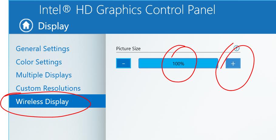

To resolve the issue of the black border appearing around the image on the external display, you can try opening the Intel HD Graphics Control Panel. To do this, right click on the desktop and choose “Intel Graphics Settings”. Then, go to the “Wireless Display” section and increase the “Picture Size” to 100%. This should resolve the issue, as the picture size was previously defaulted to 75%. It may be helpful to note that the picture size should default to 100% to avoid this issue in the future.
