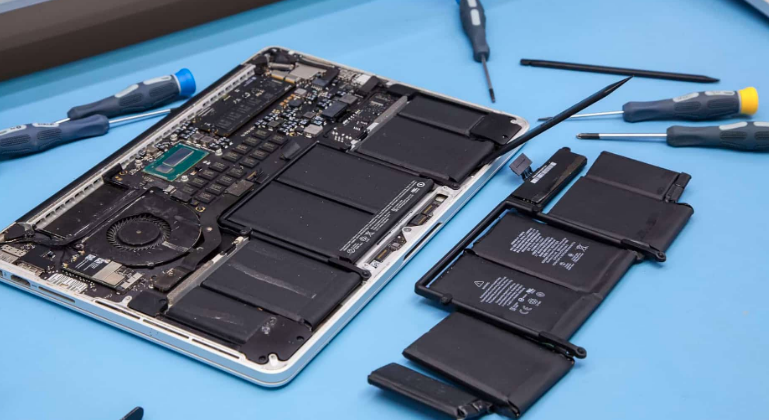

Cool, it looks like your battery is over.
There are two important measures you need to observe in a laptop battery: voltage and amperage.
What happens is that your Mac shows that the battery is fully charged due to the voltage, but when you disconnect the laptop from the power cord it shuts down due to not having enough ampere in its battery.
You can use some commands on the terminal to check the battery’s amperage.
Type in the terminal:
[apcode language=”bash”]
$ system_profiler SPPowerDataType
[/apcode]
This command will display a series of information about your Mac’s power settings.
To see only the battery information and find out the current amperage, type in the terminal:
$ system_profiler SPPowerDataType | grep -i "charge information" -A 10
[/apcode]
This will show a screen like this:
Charge Information: Charge Remaining (mAh): 2483 Fully Charged: Yes Charging: No Full Charge Capacity (mAh): 3427 Health Information: Cycle Count: 1453 Condition: Service Battery Battery Installed: Yes Amperage (mA): 0 Voltage (mV): 12233
[/apcode]
As you can see, even though the voltage is high, there is no amperage in your battery. This means that the battery does not have enough power to turn on your Mac.
So when you remove the power cord, the battery doesn’t support your Mac’s power demand, so it shuts down.
The solution may be to replace your battery with a new one. Prefer a battery with a warranty of 12 months or more, even if it is more expensive, it should last much longer.
If you have manual skills, you can buy a battery online and replace it yourself.
Just open the bottom cover of your Mac (removing and marking the position of the screws), remove the flat cable that connects your battery to the motherboard by opening the molex connector with a tool and then carefully remove the part.
The battery design may vary, but the replacement procedure is similar to any laptop.
After carefully reassembling your MacBook Pro, you will see it working as new.
Enjoy!
