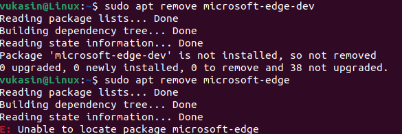

I’m trying everything to remove the edge from ubuntu but so far I haven’t had success.
Already tried:
<code>sudo apt purge microsoft-edge-dev sudo apt remove microsoft-edge-dev sudo apt purge microsoft-edge sudo apt remove microsoft-edge</code>
So I see this error message:
Edge is still in my favourites bar and opens normally.
Can anyone help?

Depending on what you installed, try:
sudo apt purge microsoft-edge-stable
or
sudo apt purge microsoft-edge-beta
or
sudo apt purge microsoft-edge-canary
