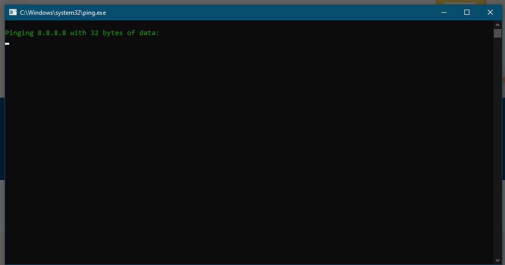

Whenever I attempt to ping an IP address or any other type of network connection, the Command Prompt (CMD) displays an empty screen.
What actions should I take? I have already ensured that all of my drivers and Windows operating system are up-to-date.
Update 1: I attempted to create a new local account, but it was unsuccessful. I also tried disabling my antivirus software, but experienced the same result.
Update 2: In my situation, I found that when I upgraded my Windows using a downloaded ISO file and installed it without losing any data, my ping command started functioning normally again. However, I am unable to determine why this issue occurred in the first place.

The only alternative solution to reinstalling Windows that comes to mind is performing an In-place Upgrade. However, it is essential to take necessary precautions such as creating proper backups, as this process is equivalent to a significant update of the Windows operating system.
