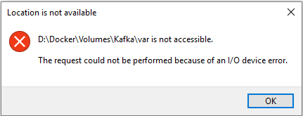

This is not a major issue, but whenever this happens, I receive an I/O device error on my hard disk drive:
- The drive is present in “This PC”
- Sometimes I can create a file on that drive (and add some content to it)
- I cannot open any file which was created before restart (files get opened by programs, but cannot be displayed – some app-specific errors)
- I can open some directories (different path depths), but most cannot be opened
- Disconnecting and cleaning HDD connection does not help
- Restarting OS does not help

Upon checking the Windows Events logs, there is nothing noteworthy apart from numerous instances of warnings similar to the following:
The system failed to flush data to the transaction log. Corruption may occur in VolumeId: D:, DeviceName: \Device\HarddiskVolume7.
(The I/O device reported an I/O error.)
