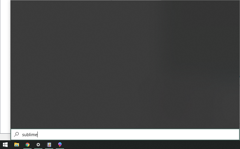

I relocated my desktop computer to a different location not too long ago, and since then, I’ve been experiencing some issues with the Windows start menu search function. Normally, I would press the Windows key and type to access various programs, but now the search field remains empty after I type. Occasionally, the progress/loading bar at the top of the search window will flash on the left side.
Here’s what the search window looks like as an example:
I have observed that the Cortana process in the task manager appears to be consuming an unusually high amount of system resources. More precisely, it seems to be related to the SearchUI.exe process.
