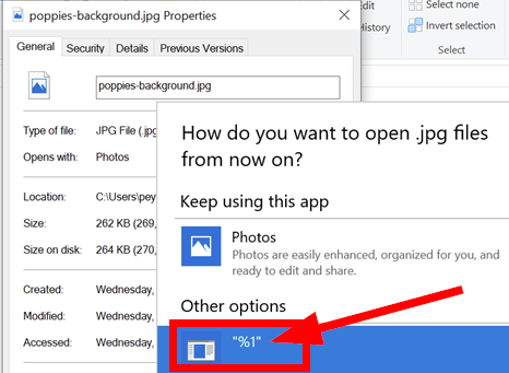

I have noticed something strange on my Windows 10 PC and I’m wondering if someone can explain.
Observation:
When I select Properties > Change on a .jpg or .png file and view the list of available applications, there is an application labeled “%1” (double quotes included).
This option is not listed for .pdf, .docx, .mp4, .pptx, or any other non-picture file types that I have checked. However, I have not checked .gif or other file types.
I have searched for this application in my system files and have not been able to find it. This option is also not available in the regular “Open With…” list; it only appears in the “Change” list. I have not tried to open any file with this application because I am not sure what it is and do not want to risk any harm to my system.
Can anyone explain what this is, how to prevent it, or provide further details about what it might be?

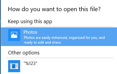

The problem being discussed is the presence of the application “%1” in the “Open With | Choose Another App | How do you want to open this file?” pop-up screen when trying to open certain image file types.

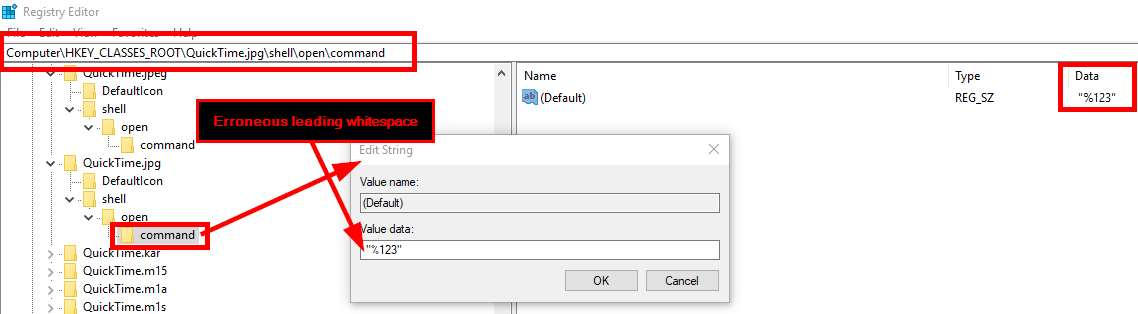

This issue has been discussed in a 2014 forum post, which mentions two potential solutions. However, the present discussion delves deeper into the cause of the issue, which seems to be related to certain versions of QuickTime creating registry settings that include a white space before the value “%1“.
The issue can be traced to Windows Registry entries created by QuickTime. It is suggested that Apple should correct the relevant registry data, which is listed below. A discussion about this issue can be found in the Apple forum at https://discussions.apple.com/thread/6699484.
[HKEY_CLASSES_ROOT\QuickTime.bmp\shell\open\command]
@=" \"%1\""
[HKEY_CLASSES_ROOT\QuickTime.dib\shell\open\command]
@=" \"%1\""

There are two suggested solutions for this issue. The first is to install the latest version of QuickTime, which may resolve the problem for some users.
The second solution is to manually remove or correct the erroneous data from the relevant registry keys and remove the leading white space.
The issue can be easily reproduced on a Windows 10 machine by adding a white space before the value data in a specific registry setting. Removing the leading white space or the value entirely will resolve the issue and the “%1” option will no longer be listed.
It is important to note that modifying the Windows Registry can be risky and can cause serious problems if done incorrectly. It is recommended to back up the registry and create a restore point before making any changes.
It is also suggested to seek assistance from a qualified IT professional if you are not comfortable making these types of changes to your system.
